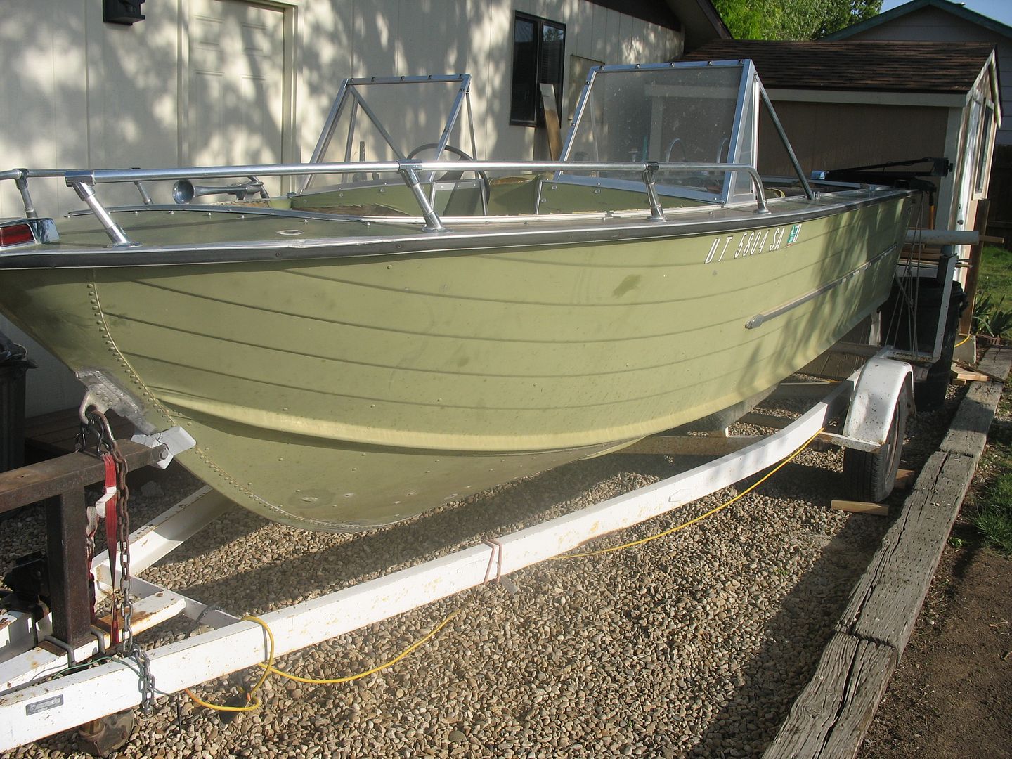

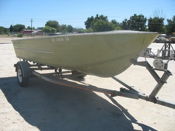

I set up a photobucket account and will try getting a couple pictures posted. These pictures are some I took after backing into the driveway and just prior to one of my adult daughters observation of "does it float"? I have been bombarded with many similar responses from family and friends. Non believers!

AHHHHH avacado green gotta love the 70's. the hull looks to be very straight on the port side. Don't worry about the naysayers, there is all kinds of proof that they float right here in the Starcraft forum

She's a beauty and great candidate for restoration! The offshore is a beefy SS made for tackling bigger water. From what I see in the 2 pics, no corrosion on any of the trim...a little ding in the port-side rub rail. The port-side bow rivets look to be a little wonky...and one has a stain around it perhaps from an external sealant? :noidea: Since it's been gutted, have you done a leak-test? Also, the bow-eye has been reinforced.

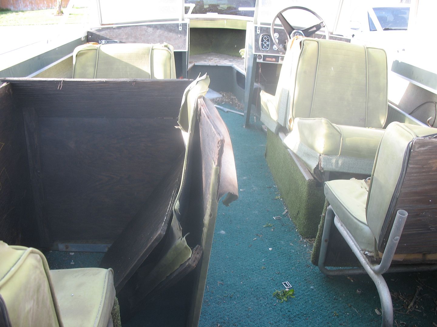

Adding an interior picture and a couple pictures of how the boat appears now. It is ready for a plastic media blast and has its replacement trailer. Heading out of town for a few days so I will update when there are changes. ops

Now it's official your a card carrying member of the Starmada! Complete with avacado head knocker seats the off shore is very vintage 70's. That old trailer should sell if fixed up a little you could get some rebuild cash out of it.

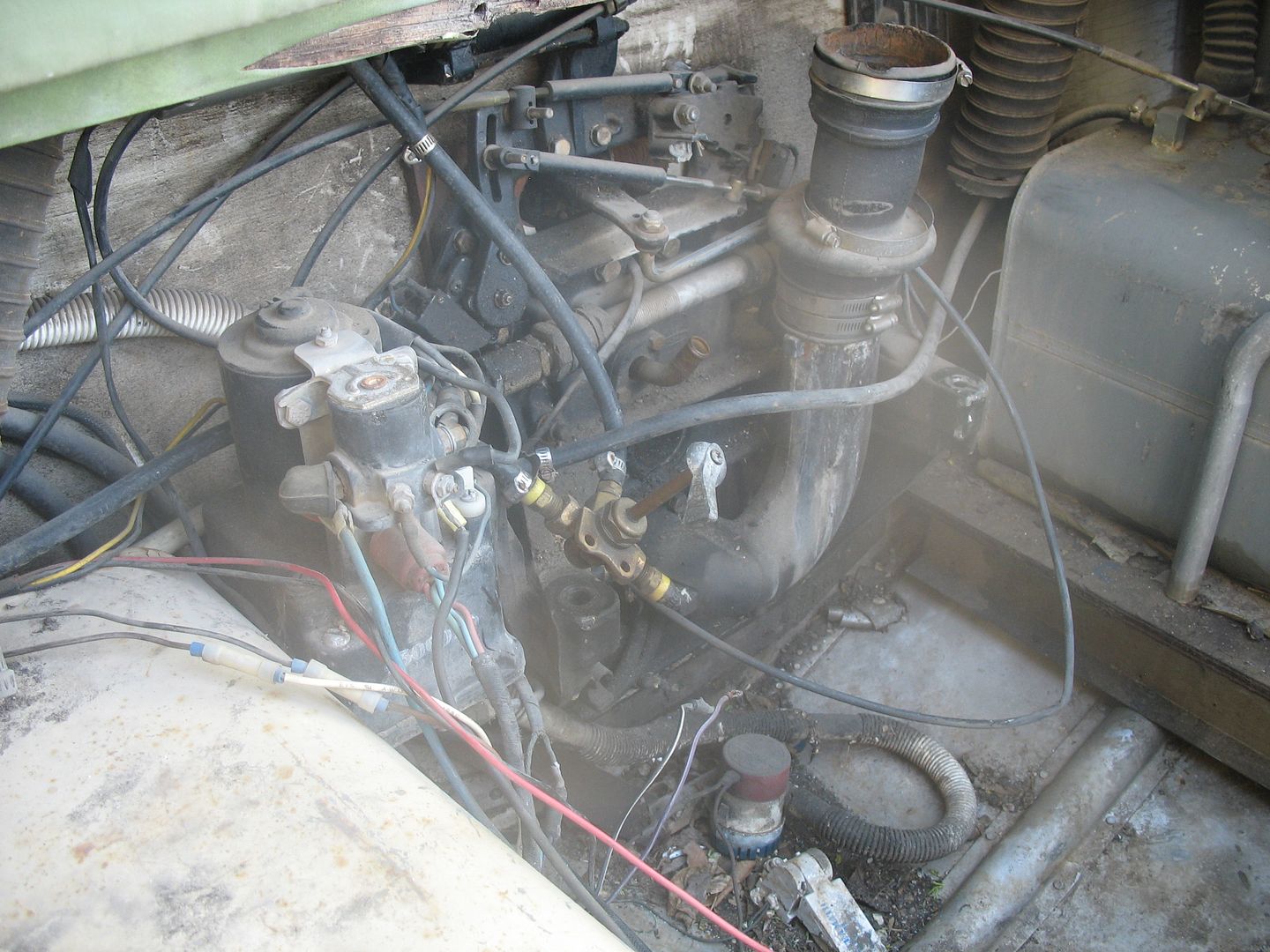

I am posting a picture taken just after the 140 was pulled. You can see that the boat had two 15 gal. fuel tanks which will be replaced with a below deck Ameri-Kraft 30 gal. tank. It measures 6 3/4 X 18 X 79.....Has anyone else done this on a rebuild?

While you have the motor out, think about adding a second bilge pump. I/Os are always a pain to work in bilge under the motor.
Tanks have been moved under the deck. It's all a matter of having the room. Over 6 1/2' is pretty long, but you have a long cockpit, too.

So when you pull off the transom cover and take a look to see if the ply is starting to delaminate. From the pic it's the original from the factory as seen by the white color and it's extremely filthy like mine was.
Yeah the below deck belly tnak job has been done before. It was pretty easy.

Very appreciative of the picture. I have been concerned about how to fit the tank in snug but still leave room for expansion.

Yeah there was rot and de-lamination, 40+ year old plywood is on borrowed time even if it doesn't have rot.
On the tank, I did have to do some modifications to the deck supports by moving them out to accommodate the width of the tank which made me have to add 1" height to the deck. I have a 1/4" of room on each side as that's the CG rules call for with fuel tanks. The tank rests on thick neoprene strips and the hold downs also have neoprene under them. The poly tanks don't expand outward, mainly upward and I have lots of room there.
Everything about fuel tanks is here. http://www.uscgboating.org/assets/1/AssetManager/ABYC.1002.01.pdf
