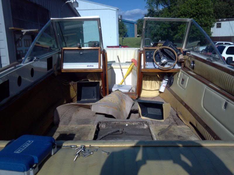

Well I bought this boat last fall for $950 and I'm finally working on getting it summer ready. My budget is small and my time short and longevity is not a concern right now. The floor is trash and the bulkhead and front floor support are collapsed. On top of that one motor mount pad is collapsed. I'm working on making it as solid as possible for the summer. I'm not sure if I have the time to sort out the fiberglass and rebuild the supports so I'm looking at options to build over it.
I took out the seats/side panels and carpet the other day to get a better idea what I'm working with.
