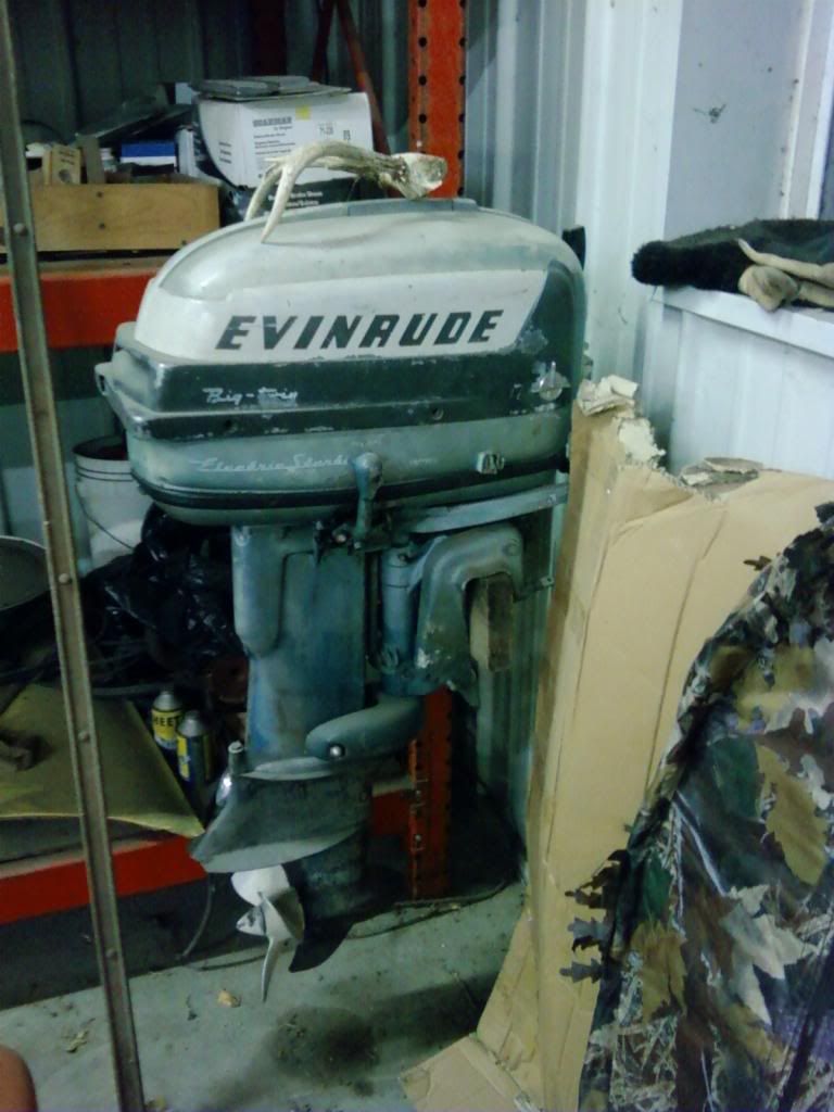

This is the motor plan,
It is a 1976 Evinrude 55hp short shaft wich is currently attached to my first boat a 14ft fiberglass El-Rae ( I know nothing about it, besides I found it in the weeds... seriously). The El-Rae structural integrity is somewhat of a concern and is why I bought the Starcraft, an upgrade? The motor runs great and have had no problems with it.

No i got the motor from my parents for my birthday couple of years ago. I have been running the El-Rae for about five years now. I had a 1956 Evinrude 30 hp on it first. Ran like a champ too but I needed more power.
