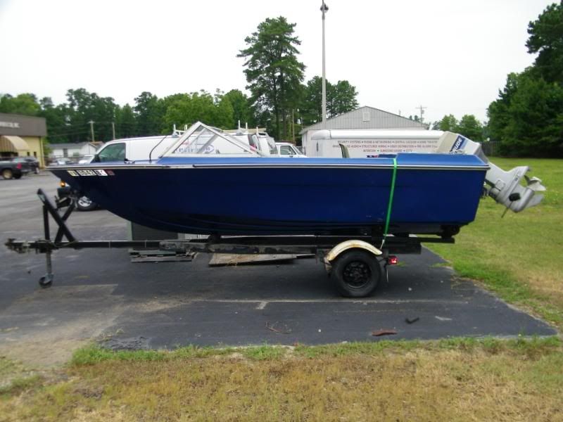

Well, here she is. The paint is not as good as it looks in this pic. No matter, it's getting restored to it's original color this winter.
Another view from the port side. I love the lines of this boat.

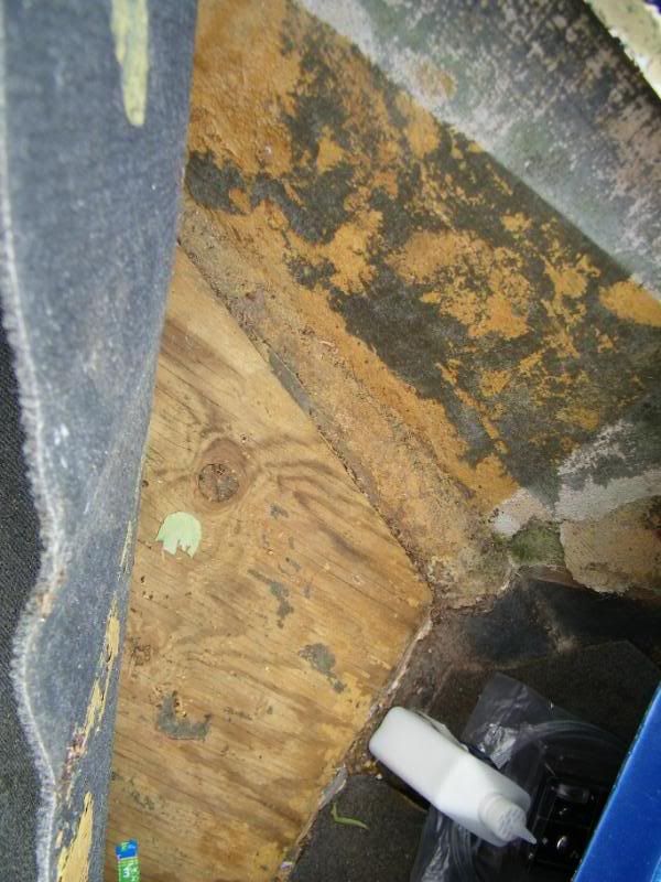

Now to the down and dirty. The PO installed a "new" floor of raw plywood and covered it in carpet.
Here's what it looks like under the carpet. Nice glass work eh? Like I said before, there's no telling what I'm going to find under there.
Same thing up front.

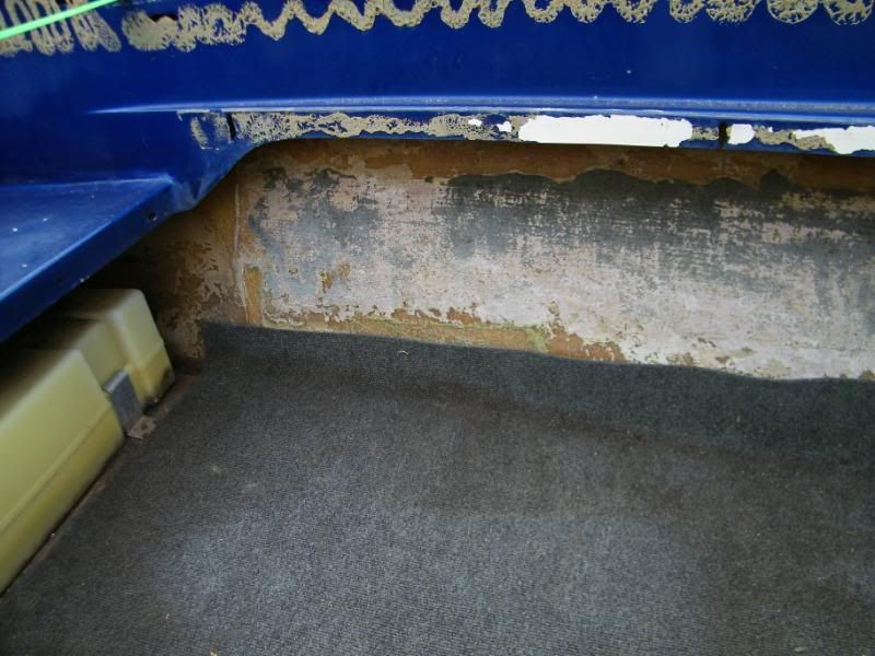

Here's where the questions start. As you can see in the pic, the OP removed everything from the sidewalls. The is no support left at all on either side. What would I need to do here (if anything). Any advice in this area is greatly appreciated.

Whats with all the adhesive?
I have no idea. I'm assuming it was used to attach some type of cushions or other covering. It's everywhere. Luckily it seems to come off pretty easy.

You could add knee braces at the transom if you think they're necessary. What kind of support are you looking for on the gunwhales/sides? If the floor is redone properly and glassed in, it adds support to the hull. The floor/deck is an integral part of the structure in most f-glass boats.
