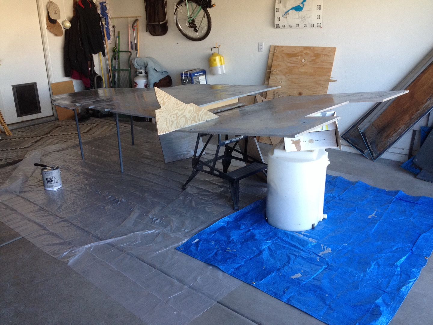

Re: 1972 Starcraft SS 18' 140 Mercruiser
I will keep track of my formula and post it hopefully along with a color sample. The boat came with two bimini tops, a brown one with two bows and a sort of turquise one with three bows and a matching boot, almost brand new. I am going to keep the three bows and try to find just a blue cover and boot. The rest I guess will go on CL.
I was trying to take apart the shift /throttle control box today so I could spray it, but once I separated the two halves it looks too complicated to remove the cables. I guess i will just spray the box and shift letter while its hanging over the side of the boat. The black lever on the back side wiil have to be painted by hand with an artists brush.
