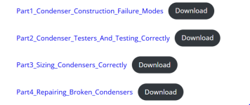

next are condensers (capacitors) you can either replace or test appropriately with a high voltage test box with about 275VDC to see if they are shorted or leak .... replacing is usually easier
visit western region AOMCI site for great articles on capacitor testing and rebuilding
download these topics...
