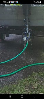

Got a 1972 evinrude 6hp, can't get water to come out the back, replaced the water pump kit, got water hooked up to intake and get it running and water won't come out the outtake

In the first place, the water pump doesn't actually "pump" while running on a hose, it only allows hose water to get through if running. Suggest you run it in a suitable tank of water to see if it actually needs fixing.

The water intake is behind the prop on this motor.----If you used muffs what style did you use ?

Muffs are useless for diagnosing cooling system. Lake test or barrel deep enough to submerge waterpump.

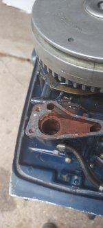

OMG I opened it and nothings in there lol, that's why no water coming out?

water should still be pouring out ...
try backflushing from the thermostast housing inlet and outlet ports
39,904
Folks often take the thermostat put when they are unsure of how to proceed.- Motor should still pump water.

The gasket for those is thick. Look for a BRP/OMC one -- think I've used Sierra (via NAPA) and that worked. Cover has to be torqued down evenly, and should prep the mating surfaces.

the rim gasket fits all around and over the thermostat rim and sits nicely in position in the recess
