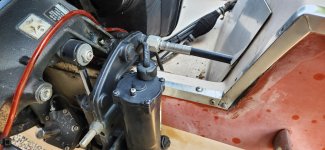

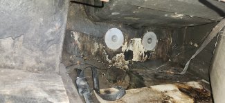

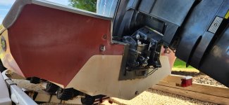

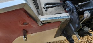

On a likely related note can somebody tell me what this hole is for? Located just forward of outboard midway on transom. I thought it was a drain that allowed trapped water out the back of boat but after cleaning it out it is a blind hole... Do you think this was originally a through hole on the Glastron that got covered up when the force motor was fitted? Any ideas would be greatly appreciated, as it sits this seems to be a place for water to collect and rot the wood out only and I'm trying to determine if I should create a exit path in this location? Thanks everyone.

That's the splash well drain. All outboard boats have them

As an engineer and a realist, the aluminum plate is a bandaid applied over a broken back/legs/etc of the boats skeleton. it may offer a bit of comfort, however it wont keep the motor and transom attached to the boat unless there is also aluminum plates sistering the stringers and knee braces going forward holding the engine to the rest of the hull.
Look at the load path of an outboard motor compared to an I/O. the outboard motor is constantly trying to pry the transom off the boat with a long lever arm
Now relook at the aluminum plate.

Can someone please tell me if the splash well drain is supposed to exit out the back of the boat straight through transom? It has to correct?

Ayuh,..... Welcome Aboard,...... Yes, straight out through the transom,......
What that hull needs is to be torn apart, 'n the transom wood Replaced, as the internal rot is way past sistering,.....

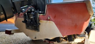

regardless of the motor on the boat, that transom started rotting about a month after the boat first came out. the encapsulation around the lower drain hole is abysmal. regardless if the splashwell drain was there or not.

On the first photo, where the motor well is shown, it appears there's any number of cracks between the well and the inner transom. Then add in the hodge podge half-baked aluminum/sheetmetal reinforcing that looks like its slowly being pulled through the transom....
If that were mine, I wouldn't be stepping foot on it until it was repaired.

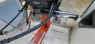

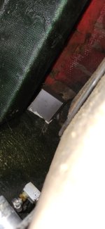

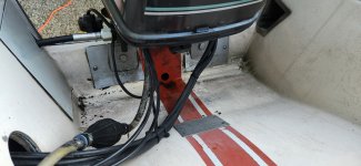

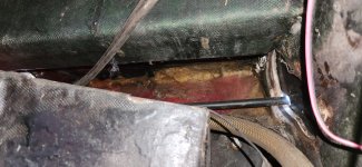

I'm a bit scared to post these here because I too have eyes, but I feel there are some people that might enjoy being validated in their clearly accurate observations haha.
Fix or replace... fix or replace...Thanks all for the hard truths. Time and lack of maintenance is cruel to all the things we love. I'm no stranger to sinking way too much money into old things, so hey what's another money pit. My only consolation is that for what I paid, I pretty much bought a decent running 120hp motor and got a free boat with it... yeah, let's go with that... and for those following from the start there is clearly NOT enough reinforcement nor would any amount truly solve the problem in any long lasting fashion, I will eat my words and agree that this thing is a ticking time bomb.

Save your motor and look for a decent aluminum hull, you won't have all that rotten wood to deal with...at best a floor and transom, but much easier and less expensive as well as better resale value !!
