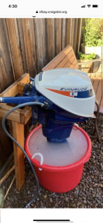

Hey guys so I just purchased a evinrude 9.5 1971. When the guy I purchased it from demoed it for me I noticed that it started fine cold start on first pull. Compression test was good, spark plug wires look brand new and plugs. Engine looks amazing overall like it has very low hours. It started to misfire a little bit then start running fine . Owner said the gas was a year old and it definitely looked and smelled old. Could this be the reason for this misfire ? Should I do a carb rebuild or just try to run some sea foam first to see if that clears anything up.

doing a carb job is not complicated see good utubes ...it is good insurance dont forget an impeller and new gear oil (check for water intrusion)

Some love those light weight ( 60 lbs ) motors and other loathe them.-----Start with doing a spark output test.-----See if both leads have 1/4" spark or more on a testing device.----These motors are famous for cracked ignition coils.----There are very few ( if any ) of these motors still running nice with original coils.----First thing I do on any of those motors , 1-1/2 to 40 HP is inspect ignition coils.----Usually find new coils.-----If they are cracked it might be a bonus as the motor has not been used a lot.

Sounds good will pull fly wheel and come back with results as well as begin a carb clean and rebuild
