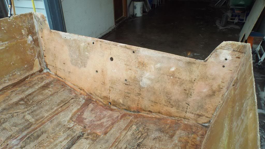

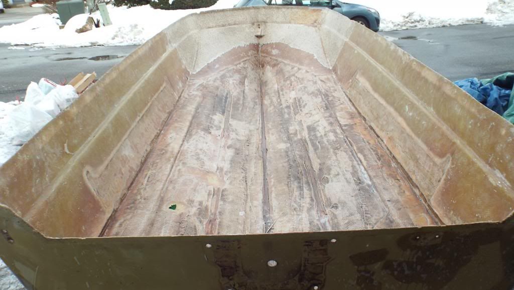

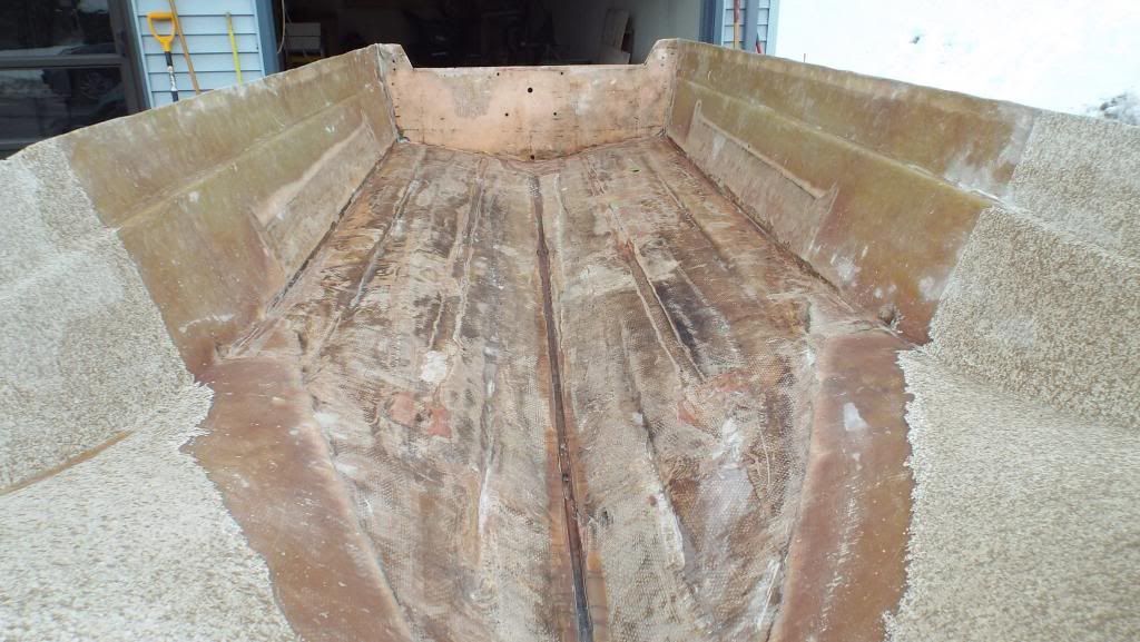

Update, Pictures.
Going to keep grinding today all most done grinding!
Here are my pictures before I started grinding today
First 4 pictures are just pictures to see the progress the 5th picture is the oops that I ground to far.

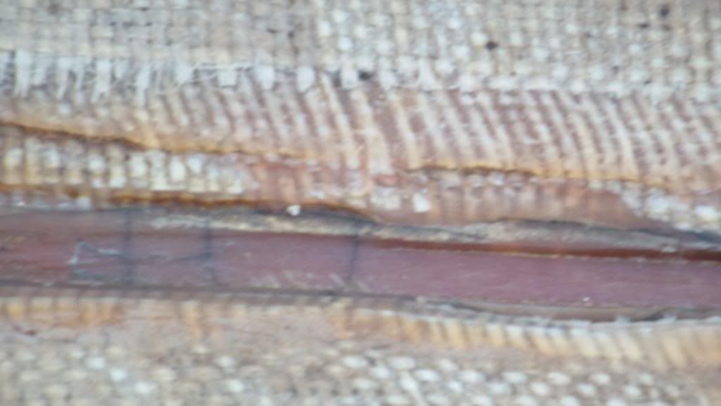

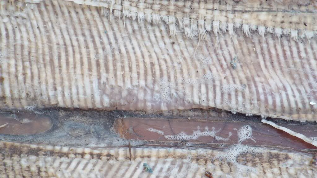

and this final picture is the best picture i could get off the center stringer.. Hopeing that is far enough you can still see an indent of the old stringer but its all peanut butter, i assume. is that ok? or do i need to grind the PB all the way down.. that stuff is brutal to grind down.PB1.jpg
Also another smaller oops in this picture

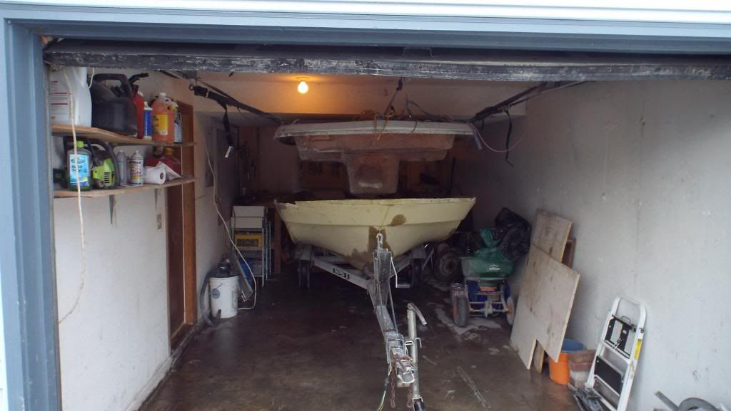

Hey Guys,
Got a lot of Garage cleaning done today and was able to wipe down the inside of the hull, really helped me asses the grinding and what else I need to do.. Took a lot of Pictures today!
This First two are just shots of the entire Hull(and my new car in the background(not my tow vehicle!))
Picture of the transom
Center Stringer, I assume what is left is PB? Need some help on this.. is it necessary I grind this down to the glass? It is very hard to grind down in a tight spot.
Similiar Picture but seems like some wood is left there definitely need to continue to grind here.
Picture of my garage in its current state! I missed in my research the importance of bracing the hull to protect from the hull expanding. I hope this is not a deal breaker, I did measure originally and luckily as you can see I can lower and raise the cap easiliy (pulley and chain fall) So worst case scenario when I am rebuilding stringers/deck just lower it to get it to correct dimensions?

The PB in the keel is ok to leave in but you need to grind out any loose fiberglass in the areas you will be laying new glass like in the second picture. As far as flipping the hull I was told by woodonglass to wait until the transom stringers and deck are back in to avoid cracking the hull. However, I have seen it done in another thread with a tri-hull before.
