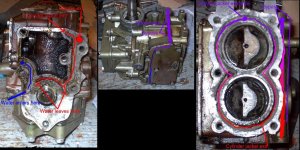

see picture clean out the lower exit route check bypass exit back flush it
install the head gasket and cyl head back flush from cyl jacket exit water should flow back out the entry point

if the impeller /water tube section is ok .try REVERSE air blow out starting at the water EXIT points
I have never tried it myself but you may be able to fish a mono line all the way across the water entry to the exit points shown the picture above or possibly vice versa .
check the base gasket for obstruction on the exit route .. yet with plenty of lukewarm water out the small lower holes some water is circulating so the pump/tube must be ok. the cyl jacket portion is getting hot so recheck/focus on the water supply hole above the top cyl and exit at the bottom
you can always try to circulate windshield washer fluid* in the water channels to see how good or not it actually flows out the discharge paths
