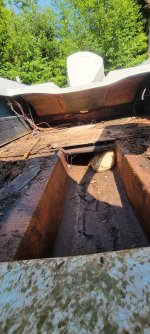

Hi all -
I recently scored a lovely 17' 1969 Glaspar (not sure if it's the Citation or "Flying V 175"). The floor deck is rotten in places, so I've pulled up the "rug" and started hacking away at the plywood underneath. I was expecting to find stringers under there, but instead I've found a) 3/4" ply sitting atop 1/2" ply (with a glass layer in-between), sitting directly on top of foam. Is that expected? Or are there stringers "hidden" in all that foam? I honestly can't tell if the underlayment plywood was just glued to the foam, but I've seen no evidence of fasteners.
Follow-up question: do I need to replace the foam, or will replacing the ply with marine plywood and CSM fiberglass be reasonable?

That's a reckless 3/4 deck over cosmetic temp fix by someone to hide a bad 1/2in deck.
Likely Full gut & rehab

Oh, interesting...so the original deck was just the 1/2" ply with glass (presumably top and bottom)? Should there be stringers somewhere inside that foam, do you think?

Looks like fiberglass stringers. May be foam cored.
Yes, it is a good idea to add the foam back in.
52,558
Yes.
The deck-over is a common practice by unscrupulous people to sell rotten boats
Your transom and stringers rotted 10 - 15 years before the original floor rotted
Time for a complete rebuild
