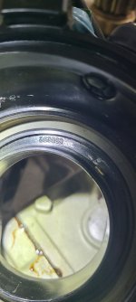

68glasspar
Aug 28, 2024
118
i think current part number is 383522

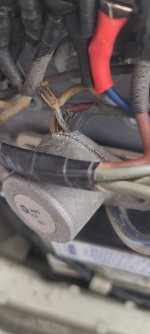

68glasspar
Aug 28, 2024
118
The 382480 was only used on the 1968 100 HP as far as I know.---They all " appear " to be the same to some E-BAY sellers !!
I think i may have found my problem, or at least another problem. My battery is old and quickly drops to 9.5 volts, So it has a bad cell. I will replace that. But also need to replace my voltage regulator due to crumbling wires. (see pic). Once i get that done i will go back over the spark tests. I may have just had a low voltage problem and an inoperable charging system!
68glasspar
Aug 28, 2024
118
I got a new battery and voltage regulator installed. I don't have a water hookup where im working on the boat, so i can't run it to see if its charging now. But i still have my ignition spark problem. Spark will jump 3/8 or better on the coil wire, but only jump .095 at the spark plug wires at cranking speed.
The ignition wires are solid core original wires and ohm test less then 1 ohm.
The primary side of the coil also ohms at 1ohm.
The repair manual says the amplifier output is 300 volts to the coil, should the 300 volts be present at cranking speed?
