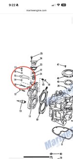

I have a 65 9.5 twin sport that I’m having an issue with the armature I’m guessing. It doesn’t turn back and forth as much as I believe it should. Throttle indicator only goes down to shift and stops. Removed the shift linkage thinking maybe it was that and still the same issue. What am I missing? I removed the idle thumb screw bracket also and it’s not hitting the stop tab or anything else I can see under the plate. I will like a video to show the limited movement. I’ve watched countless other videos on this engine and there’s moves much more in both directions.
Honorary Supreme Mariner
39,925
Right at the beginning of the video there is a pivot screw missing at the front.----Great big hole in that linkage.--Screw is item #46 I believe.
