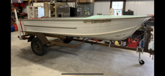

This is awesome, I am literally in the middle of replacing the floors in almost the exact same boat. 1974 Starcraft Jetstream. I have already taken out my old seats and floor boards, carpet, and foam. I power washed the inside and now getting ready to lay new foam and frame it.

Had my boat sandblasted, polished the trim, power washed the whole boat to get ready to seal the seams. Floor is the next task. Haven’t had much luck on tips here so it gonna be an experience.

64osby
Jul 28, 2009
6,826
Sealing seams on the inside , use Gluvit or Coatit. Both work well. Replace any rivets that are bad or missing, rebuck others. Have you done a leak test?
