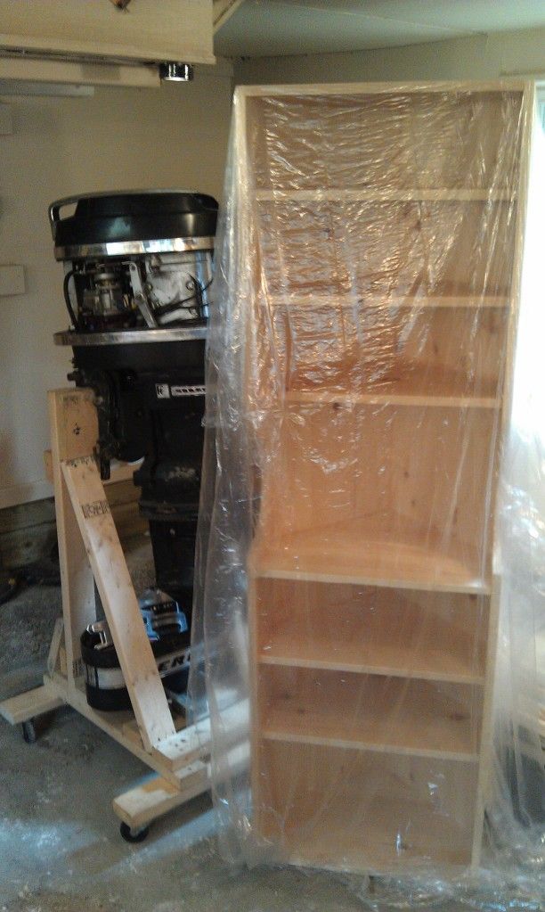

Hey Jim, what's with the early Xmas presents, you know your supposed to wait to open them.:D Merc looks real clean, hard to tell from the pic but is the crack just below the the anti cavitation plate on the rear side? Winter is coming your way, got up this morning to 4 inches of heavy wet snow?

Exactly... the crack is just below the anti-cav plate.... roughly about an inch long at this point.

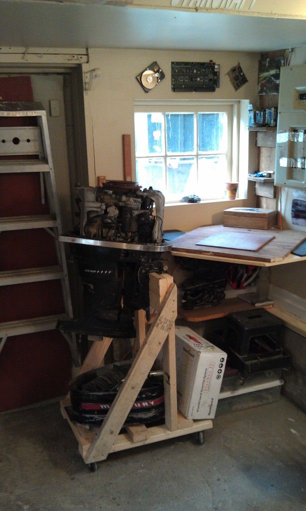

Sometimes I get a wee bit confused as to which thread to post in!... but this is I believe where this should go... :)
So here is a pic of the doner motor and the new motor work table. Made a new a motor stand out of some left over wood.
Also have 1 last project to complete for the Admiral before really getting into the boat build --- the Jet that is!!!
Just need to assemble the door pieces and attach to the unit, a final sand and urethane and it's complete
Have a great weekend fellas!
Jim

Great score on the Merc Jim, the cabinet looks real good through the plastic, I think:facepalm:, looking forward to following along.

Thanks Glen... oops forgot to remove the plastic!

My buddy has a '68 20 hp Merc that's got a crack in the same spot. It was his FIL's motor. Had some water in there and froze one winter. He JB welded it up a couple decades ago and it's still holding!

Hey BD --- Thanks for the info... good to hear that someone else out there has been able to fix it. It's a pretty good split now in my case... wonder... did your buddy's FIL JB it from the inside??

^^^ He JB'd it from the outside. He didn't take it flush either kind of left it a little proud but feathered it in. If you look right at it you can tell, doesn't look too bad though. It's held up for a lot of years! The Mercs were prone to lower unit failure in the 60's. They had the swept back lowers for styling and water-dynamics. If they leaked a little and then froze, pop! I guess that's why you change your lower lube before winter.
