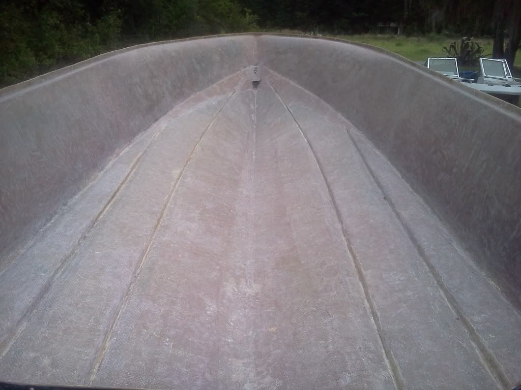

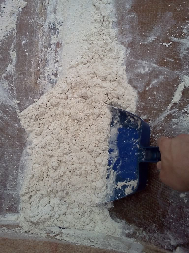

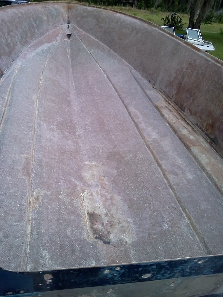

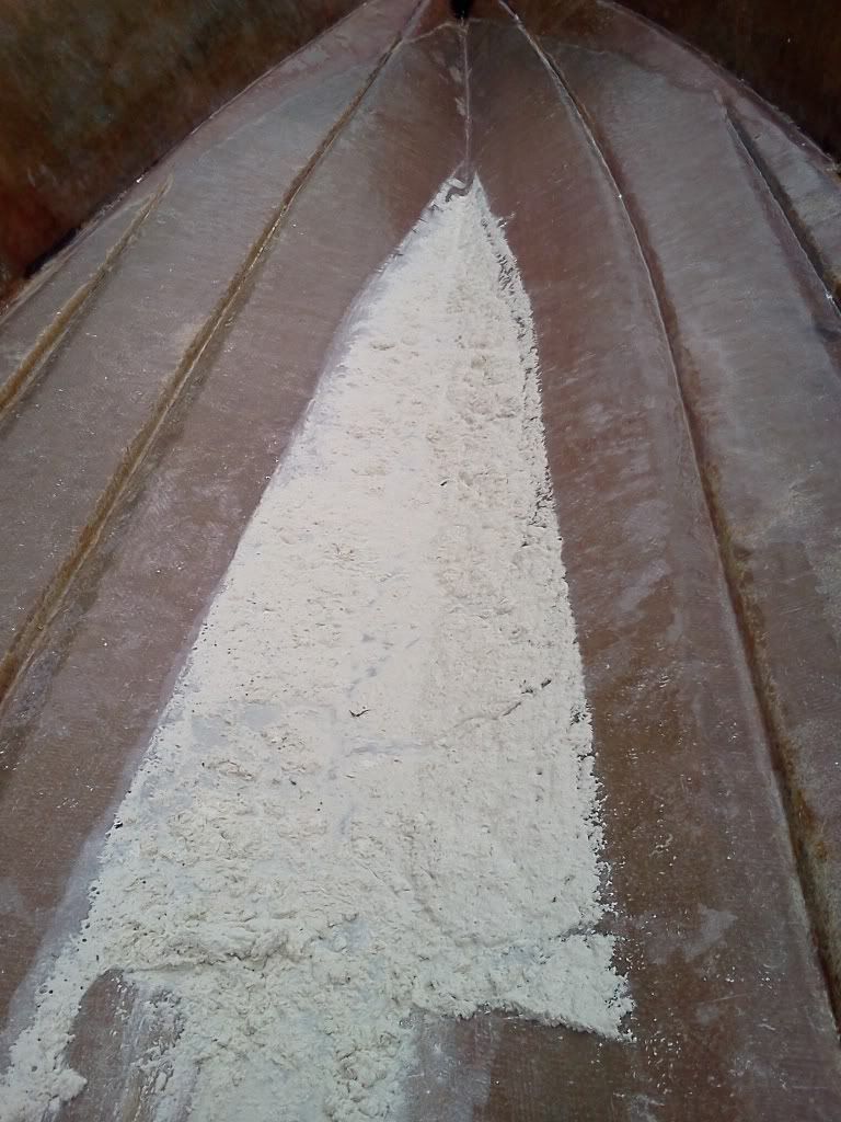

Just a quick update. Almost done with the sanding, had to stop a little earlier than I wanted today because I could feel the grinder getting pretty hot and didn't want it to burn up. I gave the boat a quick spray with the garden hose which brought all the dust down toward the bilge area and made cleanup really easy to control with less dust. I just used a dustpan to scoop up the fiberglass mud and throw it out. To me this was easier than vacuuming, I will sweep my driveway up when its dry. Here are a few pics of my progress.
http://i116.photobucket.com/albums/o25/dcsudnik03/c5610330-c473-4ec6-822e-181bf515b681.jpg
http://i116.photobucket.com/albums/o25/dcsudnik03/IMG_20130507_093929.jpg
http://i116.photobucket.com/albums/o25/dcsudnik03/IMG_20130507_175717.jpg

There are a couple of low spots from grinding. The outermost layer of the original layup seems to be CSM with woven roving underneath that. As I would grind away the old CSM I got down to the fresh layer of woven which sanded mostly smooth except for a couple areas where there must have been bubbles which I ground out smooth but created a few low spots where it seemed like I ground through the woven roving. Would anyone recommend filling these areas with fairing compound or anything or would i be able to get by with laying 1.5 oz CSM, then 18oz woven roving, and another layer of 1.5oz CSM as my layup schedule for covering the stringers?

Well I've finally finished grinding the entire inside of the hull to my satisfaction. I plan to glue the transom wood together today and let that cure for 2 days before I cut it out. In the meanwhile I am going to try to construct something to suspend my stringer template level with the plane of the deck and then use the scribe and post method to trace out the shape of my hull. I will update with some pics of my progress later.

Good job with the grinding. Itchy? Looks like a nice clean hull to work with.
I would mix up some PB and fill the low spots or you could lay up some csm start with small pieces and work your way up to larger ones....then grind smooth.

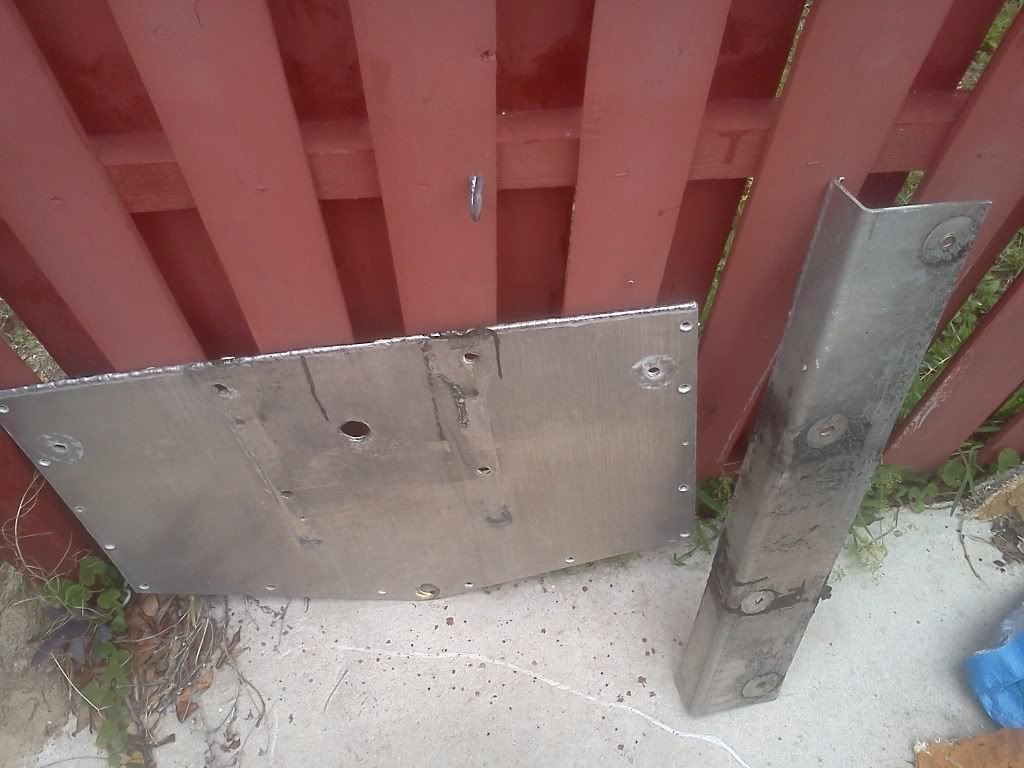

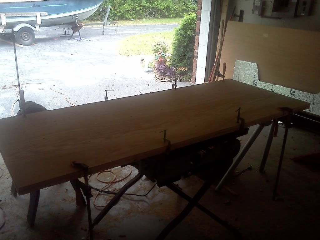

Thanks for the advice Rick. I didn't end up getting as much done as I wanted to over the past 2 days but did manage to get the transom wood glued together. I used titebond III and stainless steel screws that I countersank. I am considering keeping the screws and filling them over with PB. I need to wait for it to dry a little longer and will probably cut out the actual shape tomorrow morning. I am also debating on whether I want to put the metal plate, pictured below, back where it was on the stern. It will have to find someone who can re-weld the smaller piece that formed the angle that covered the transom. I figure it would add some reinforcement for my heavy motor, its a 1978 Mercury V1500 V6 outboard with a long shaft. The motor runs great, I put a rebored (.015) powerhead on it that really hauls @$$.
Here are some pics

The metal plate was on your boat as a Band Aid for a Weak Transom. If you put it back on it would be a RED Flag to a person In the Know that the transom on your boat was BAD. Even though you just replaced it!!!!! Your transom, once glassed and installed correctly will be plenty strong for your motor. If you want to BEEF IT UP just add another full layer of 1708 to it on the inside when you glass it in. I would strongly recommend NOT putting the plate back on the boat. It's your boat and you are free to do as you wish. Just my opinion.;)
GT1000000
Jul 13, 2011
4,916
Re: 18ft Bonito Bowrider Restoration
I totally agree with "WoG"...^^^^^...
If you really want to add extra strength, you could add knee braces or even a couple of these...
Transom Support Plate | Bass Pro Shops
421333%5F22508
to help distribute the load points of the motor bolts...
Or fabricate your own...

Thanks for the response fellas. I will not worry about that plate then. I would like to be able to sell the boat one day down the road. This project makes me want to look out for a steal on a bigger boat with a big enough transom space for twin engines. I would really like to own a boat that would ride safely across the gulfstream to the Bahamas from FL. For now I'll keep dreaming. Anyways, the original construction had a piece of angle iron that was glassed to the inner part of the transom to help support the weight. I thought it looked like crap and the piece of iron is pretty rusted. I was thinking of grinding/cleaning it up and use it again, but do not think I will try to glass it on unless someone can give me reason to. I bought the boat, motor, and trailer for $500, $800 for the rebuilt powerhead, and about $550 in materials so far to restore the boat, I plan on about another 500. That puts me at a total of $2350 or so I'll have spent for a solid running boat that I KNOW inside and out :D I think if I can keep my total costs below $2500 I will be damn happy just for the use of the thing, but I wonder what it would be worth should I ever decide to sell.
