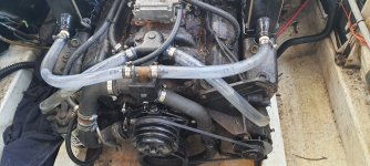

For temporary testing put on clear hoses from thermo housing to elbows and manifolds and took out thermostat (marine mechanic said it is a quick test to eliminate it as a problem). SEE PIC1 "CLEAR HOSES"
Next ran the motor on muffs (good muffs and water flow from tap supply) and saw an amazing thing .... good water flowing to elbows but NO WATER flowing to manifolds.
