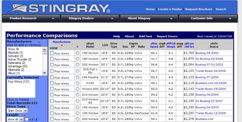

Do a little research and you'll find that engine size in a boat is not a good indicator of fuel mileage.
For example, in this data from the Stingray website performance data of the Four Winns models sorted by best economy, you can see that the four Winns 190 with the 225HP 4.3 gets better economy than the FW180 with the 3.0. The 280HP 5.7L in the FW200 is just behind the 3.0L and ahead of many of the smaller 4.3l and 5.0L motors. Fact is you're going to get 4.5 - 5.0 MPG no matter which boat you go with, but the bigger motor will make your boating much more enjoyable.
