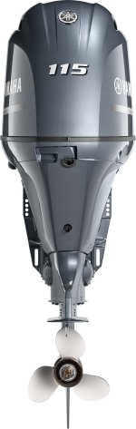

I see, I had the same thought, that since the newly added material wouldn't be attached to the 4-5 layers of cloth on the exterior of the transom, it's actual contribution to the structure would be minimal. Looking at the yamaha mounting It looks like I could use one of the middle holes, or even the bottom holes if needed.
jimmbo
May 24, 2004
14,640
The Bolt Pattern on that Yammy, is the Pattern that OMC brought out in 1960, and has been used by most Outboard Makers since the late 70s, Mercury finally starting using it in 1984 in their I6s and 66.6 4 inline, and in 85 on the V6s
