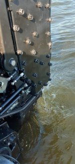

UPDATE.....we have found water from a poor sealing gasket,leaking from the large side plate that has all the bolts through it..not sure what that cover plate is called.
But...would water leaking from a gasket cause all these issues above?

Leaking from bottom

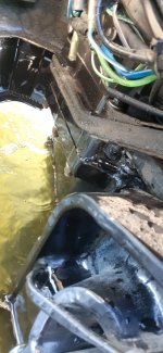

Also...water coming from front portion of engine..but only happens on the lake..not with muffs...you can see the water flowing over the one bolt head in photo
