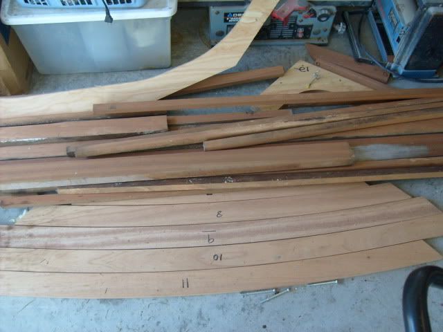

I got the plans and frame Kit from Glen L about a year ago and have been gathering materials since then I got a lot of stuff cheap when Boaters world went out of business.( steering wheel, switches, cup holders, bilge pump, wiring, and some other stuff). I picked up 3 gallons of epoxy, 10 yards x 50" of 1300 biaxial, and 30 yards x 60" 6 oz cloth for $150 off of craigslist. I also scored 21 bd ft of Sapele for $50 on CL.
Frame kit and sapele

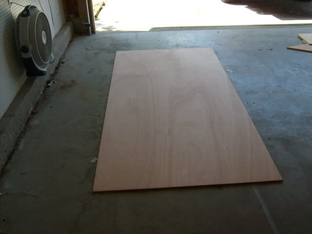

And today after a lengthy search around town for some 1/4" marine ply, I didnt want to pay $160 for shipping $240 worth of Hydrotek meranti Plywood, I found some 1/4 Okoume 1088 for , get this, $37 a sheet :eek:!!!!!!

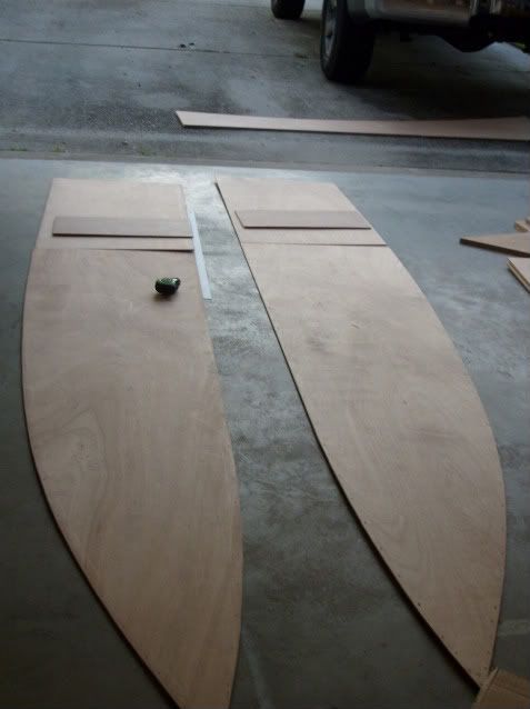

So I started to lay out and cut the pieces today didn't get very far I had to go to lumber supply and get some saw horse brackets and 2x4s to work of of. Here I am tracing the pattern to cut out
And the first pieces cut out

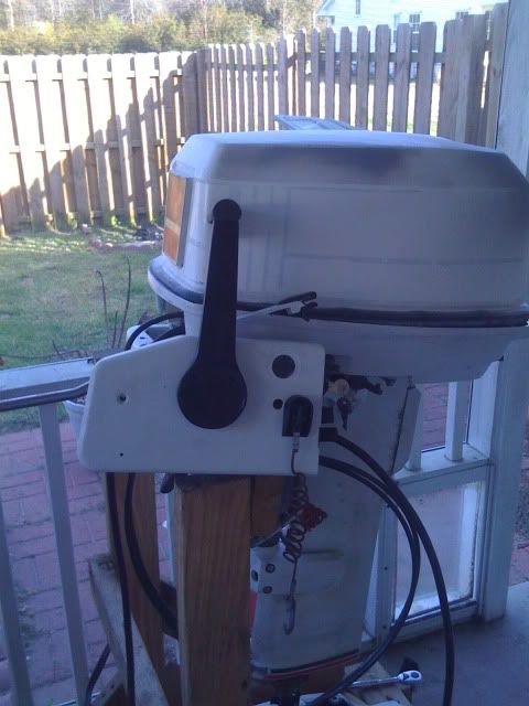

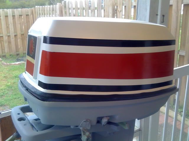

Here is the 35 when I got it a while back It needed some work
and the 25

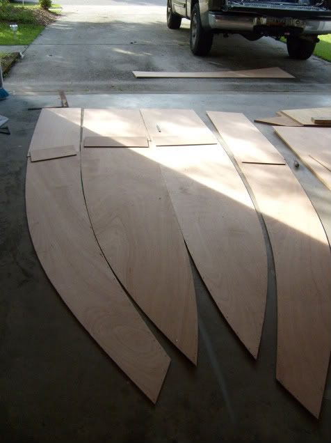

well got a little bit more work done today.

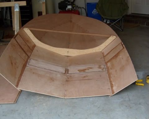

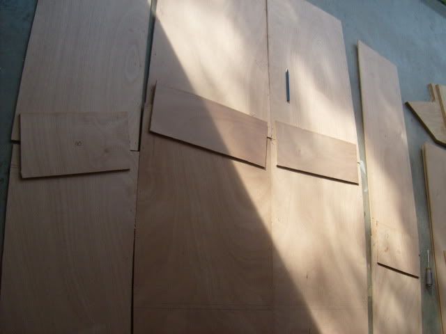

this is the hull planking all cut

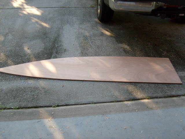

Here is the bottom planking sanded and radiused ready to make the butt joint
I have a question for you experts do you think it would be better to just glue the butt joints with some thickened epoxy or put a piece of cloth in between the bottom planking and the butt block? the plans call for just gluing them what do ya'll think will be stronger

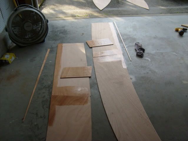

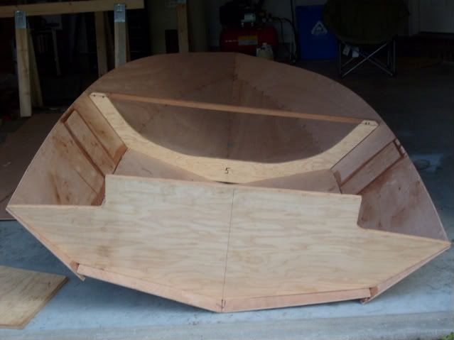

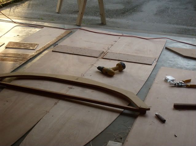

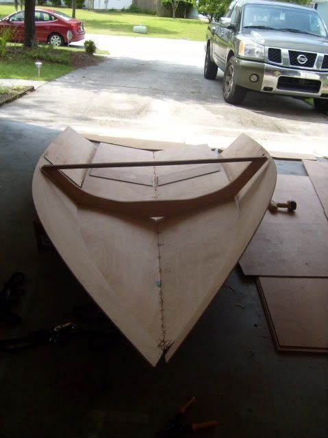

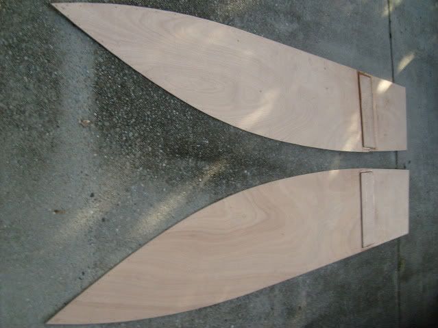

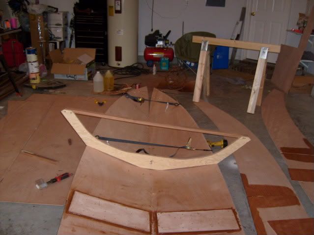

Well between all the honey-dos this weekend I got a little more done on the boat.... I started prepping the joints for the butt blocks put a coat off epoxy on let it tack up and when it was still in the green stage added some thickened epoxy and glued and screwed the butt block.
this is the side planking waiting to tack up
here is the bottom planking already glued and screwed

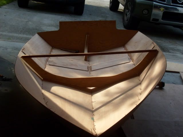

started to stitch the bottom planking together
just about got it stitched
and now it almost looks like a boat kinda

Nice work, It's good to see someone else building a boat out of 'what boats are supposed to be built of' on this site :D. (Even though you are past the point of your question, I'll say that adding some glass between the bottom & the butts won't add strength.) Please keep us posted.

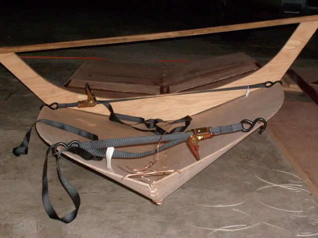

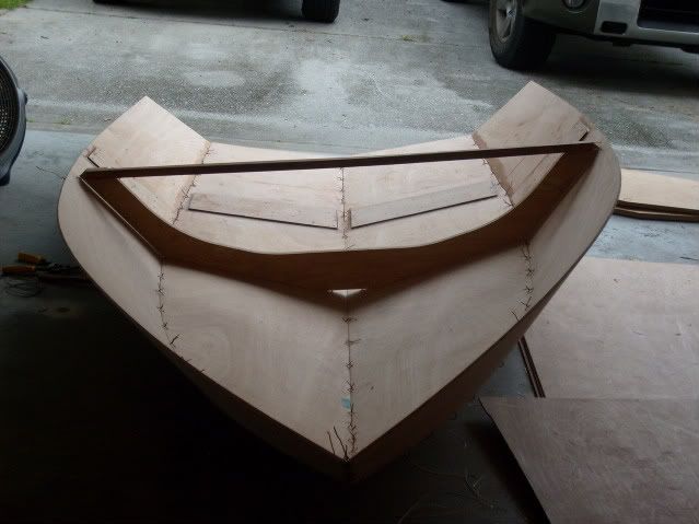

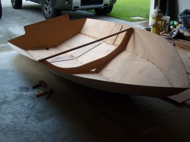

I started stitching the side planking today could have used an extra hand
Here are the sides stitched on

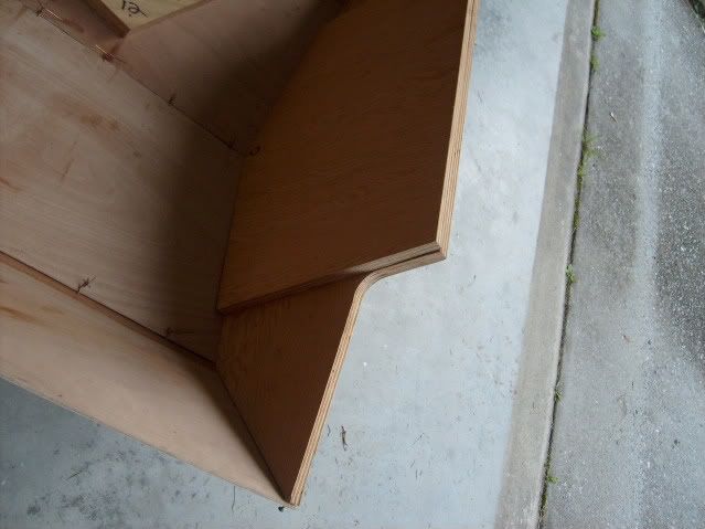

The little flaps on the bottom sides are going tho be a chine flat/spray rail
The transom temporarily in place
It finally looks like a real boat!!!!!!!!!!!!!!!!!

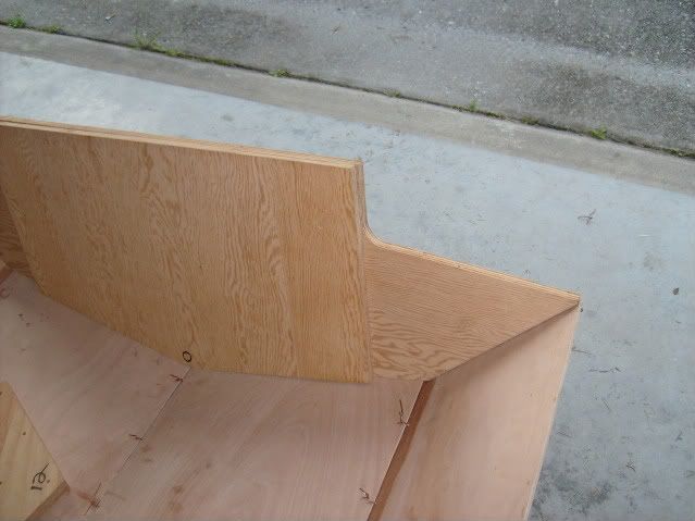

This is the motor board that came with the frame kit (the transom is 3/4 and the motor board is 3/4)
I think I am going to make a full size motor board to go side to side
It should only add 5 or 10 pounds and will make me feel better about the transom
Willyclay
Sep 8, 2006
3,276
Re: 11' Runabout build
I thought those geese looked familiar! Good move on the motor board since you intend to use the 35.

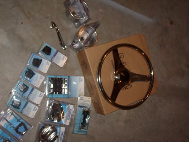

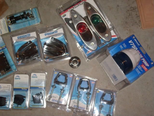

Well no real progress on the hull but, here is some pics. Here is some of the stuff I have been collecting for a while I got alot of it when boaters world went out of business. I got most of it at really good prices. Surprisingly the build is coming together pretty cheaply, luckily I have gotten some good deals(epoxy, cloth, plywood, all of the below)

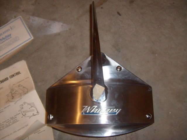

Here is a shot of the wicked cool control box I got off of ebay, its pretty old but brand new never used, it includes all the papers and they are yellowed with age It came with cables and all. I think it is going to set the interior off with the deck being mahogany strips.

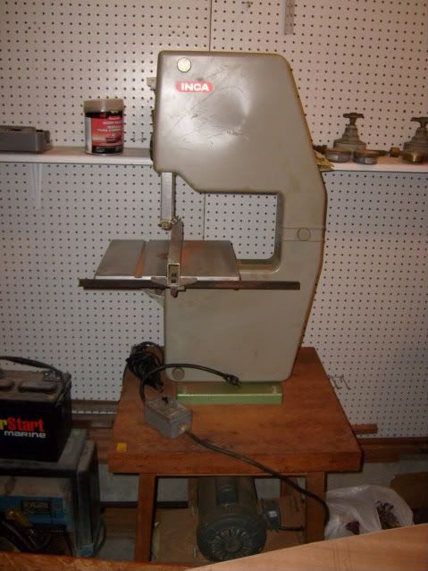

And here is a new to me tool I picked up on craigslist for $45.00 pretty good deal. The wires had been pulled out of the electrical box and the previous owner didnt want to fix it. 2 wire nuts and 5 mins it was working again.
