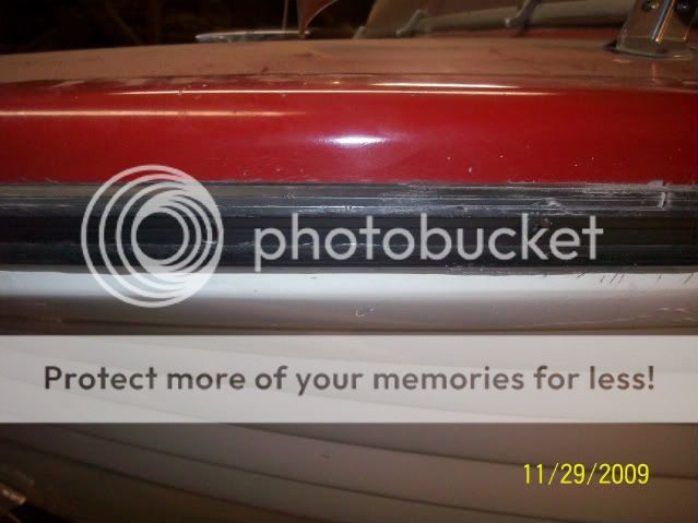

    I removed all the aluminum rub rail- there were about 100 rivets that had to be drilled out, and there were a bunch of screws as well. I plan on re-using the rub rail but getting rid of the black paint that is on it.
