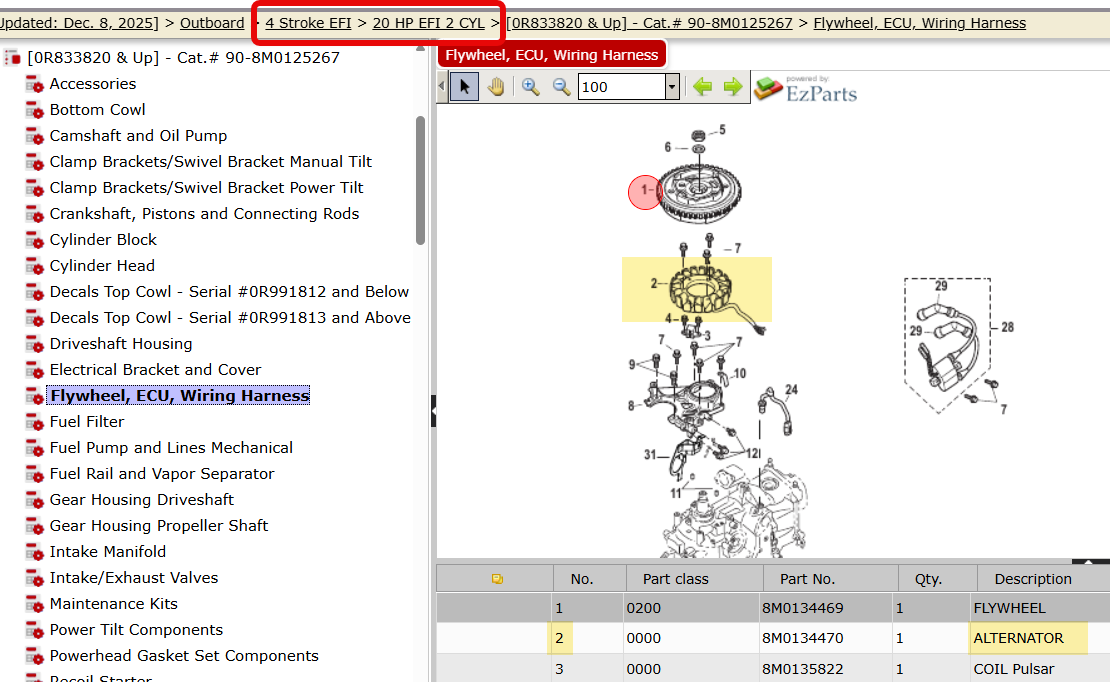

Since your model does not use a battery it relies upon the alternator to generate the electrical power needed by the ECU and the electric fuel pump. Permanent magnet alternators typically create more electrical power the faster the magnets wiz by the stator coils. Which is why the motor starting easier with slower rotation is confusing me. But I am old and get easily confused these days.
