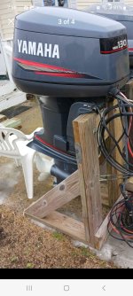

Anyone have success using a aftermarket power trim relay? Big price difference between oem and aftermarket
If so what brand did you use? My motor is a 2001 yamaha 130 hp v4 2 stroke
