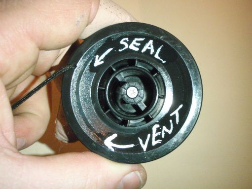

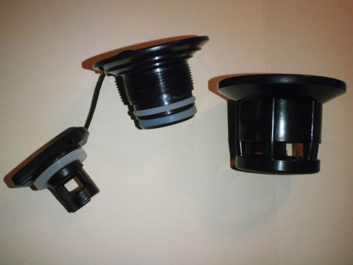

Are these Zodiac?
When your deflated do you check the tightness and or hand tighten them through the fabric?

Those are Robert Halkey air valve clones, will need a special 8 thooth tool to adjust valve bottom against fabric. Factory HR valves comes well adjusted, could break interior pins where tool locks if trying to adjust more. if thinking seal is not tight as to lose air, do a soappy water test around valve and fabric and check for air bubbles.
