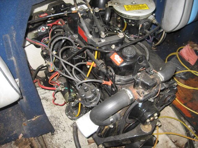

Not the greatest Picture but you can see where the front engine mount is located
Best Pic I could find, shows the bracket attached to the motor and the box it sits on that I have cut out due to rot and need to replace
