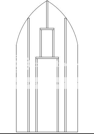

So, with all of that said; The main reason the stringers are there is a combination of structural to hold the hull shape as well as structural to support the floor and provide a place for flotation foam and storage lockers/ fuel tank holds. The structure helps to transfer torque and stress trough-out the structure as well.
What I would do is buy an inexpensive bevel gauge or protractor and use it against the floor and the transom (after your transom is in), lock it in place, and make a sample cut on an end of your stringer replacement. I would cut it at least a foot or two to insure the bottom of the sample is against the hull and check it against the transom. Also note, some stringers are not flat against the hull in a 90? angle, but angled, one left and one right.
Insure all of your cuts are tight (and the proper angle) to help restore the original strength they were intended for.
For your ski locker and fuel tank hold, simple head off your stringers shaping the header to fit the "V" in the hull. You can make the "box" wider or narrower as you need for the locker or hold. On the opposite end you can return to the original layout of the boat and reduce it to one stringer as it moves to the front or bow of the boat.
Look at previous marking in the boat if you feel that the stringers might not be in their original location. Sometimes there are tell-tail signs left from the previous/ original work.
It's like making an opening in a floor for a set of stairs or a chimney flue. When you cut, you must replace with something as structurally sound as what you cut out. See the sketch below.
All the stringers pieces can be connected using screws and glassed over with the stringers. The stringers are "glued down" using either PB (peanut butter/ a thickened resin mix) or construction mastic. PB is just as strong and does not have to "Gas Out" like the mastic does to set the cure of the adhesive.

Thanks, But that style is a little bit much for me. hahaha
I perfre the KISS method of things. I know the boat had 2 inboard stringers, Just not sure how they were laid out, the PO didnt leave much evadence on what was there before he butcherd it. All I know is that I need it to be strong and safe as the seas I run in are known for turning ugly in a hurry and pounding though 4' chop isn't all to unherd of.....
