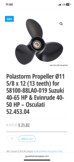

I think I’m gonna order a 11 5/8 x 12 prop, which is what Suzuki calls for and see how that one fits
