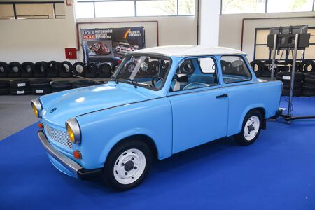

I believe the east german trabant was a 2 stroke.Universally accepted as the worst car ever made.
