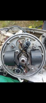

I've pulled the flywheel and replaced every part of the magneto which is why I'm so confused

Did you swap condensers to see if the weak spark follows?

so you did replace / swapped most parts ... the big variable is current flow to induce a strong spark via the HV secondary that begins when the stored magnetism collapses and the primary coil tires to sustain itself & generates a current flow which ends up in the condenser as the points open up.
did you burnish thee point surfaces and clean then afterwards
....sorry to ask!
at this point may as well work that area ..even new condensers can be bad and the only way is to test them with proper high voltage test eqpt.
make certain all connections are clean.. scrape paint of the coil surfaces
and... post results of your OHMS measurements !!!
btw.. I had a similar issue on a 4hp last year.... did all that swapping thing...and suddenly bingo it cleared up. I never found out why so don't feel bad

I feel like such a rookie right now. Swapped condensors and boom runs well. I know assuming is bad but I assumed that new out of the box condensors wouldn't be bad but I was evidently wrong. Thank you so much for the help I genuinely wouldn't have thought it would have been them due to the fact they are brand new and would have just kept overlooking them
