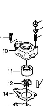

I would but what bearing in the top housing? New top housing has no bearing, old housing doesn't have one, parts diagram doesn't show one. #11 is the cylinder that the impeller inserts into.
