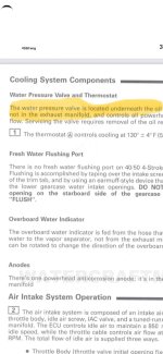

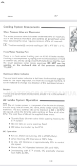

Where is it then? The manual says below oil reservoir?
39,583
Are you finding this in the SUZUKI manual for your motor ?----What manual are you using here?

I'd leave it alone and test. Run some mild soap or something. Impeller yes, stats? No.
I don't work on those motors but I've never seen a design where you don't have access to areas.

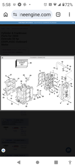

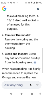

So this should be the assembly, and where does this go on the block?

I thought it was very odd placement myself and why I’m very hesitant to pull it all apart to replace it that’s a lot of work for preventive maintenance but if it really needs to be done I will do it.

you could wait for symptoms .. i doubt the engine will wipe out
purging/flushing with commercial product should wash out mineral deposits

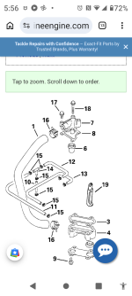

Parts 5, 6 and 7 will give you "the glory" but like everyone says....you need nothing. Follow the yellow brick road and get what the scarecrow needed. 🤓

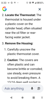

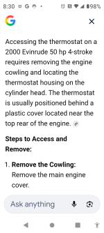

This should help
