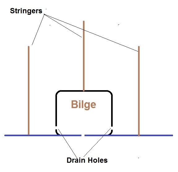

Your under deck configuration probably looks something similar to this...
Since you can hear the water sloshing around I seriously doubt you have any foam under the deck. You may have a bulkhead at the midway point. Is there a ski locker? Pics of the interior of your boat would greatly help us to help you. As the diagram shows if you would drill to holes on either side of the bilge you could easily drain the water from the boat. However as stated, if it's been there for an extended period of time it could have done some damage to the stringers and the bulkheads. Any idea as to the year of the the boat. I know some of the vintage AMF's used fiberglass stringers and you may be one of the lucky ones.;)
