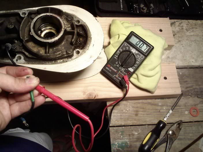

Did some more tests...went outside with my voltmeter and tested the oms. What I got was 8.1 on the blue wire (reverse coil) and .8 on the green wire (foward coil). I tilted the drive up and carefully worked the wire out of the intermediate housing and tested again to see if there possibly was contact with metal somewhere. Pulled the wire through and same readings. Took the outdrive off and same readings. Put it on my bench and nothing changed (see pics below) When I pulled the lower unit off of the leg I saw exposed wire. I thought Great!!!...that is what the problem was. Nope! Same readings. There must be contact with the case down inside..Oh no not down inside!! Never did this job before but it is an opportunity to learn. I'll keep you updated. Also what kind of material is used to insulate the knife terminals (the ones in the picture that wore through. And one last question do I disconnect them here and pull the lower all the way off or pull the lower off with the entire cable still attatched?
that's why you need a manual - they show and discuss some procedure with a caution about shearing the wires off.... among about 50 other fiddly processes and cautions
