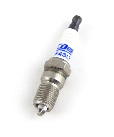

Unable to say anything about the gasket but everyone is going to iridium plugs because they say they last longer. Merc uses AC 41-993 (was 41-932)
I would use AC MR43LTS and not bother with high priced plugs but that's just me

There are no VP spark plugs, they just sell Champ or whichever they spec and then double the price. What makes the difference is the cyl head design. If you have a Vortec engine the plugs have a longer reach than if you have the pre-Vortec. Vortec has 8 bolts holding down the intake manifold pre-Vortec has 12 bolts. Do not use the longer reach plugs in a pre-Vortec. I have always used the AC/Delco marine plugs. I think the LTS plugs are extended reach.

-I learned that my spark plugs are the "long reach" type that are used in motors with Vortec style intake manifolds. The key identifier is that the bolts holding the intake down are straight up and down and not at an angle.

Ended up with AC MR43LTS. Thank you.
alldodge
Mar 8, 2009
44,384
Agree they would, but your motor calls for .060
The LTS was used before the iridium came out and they came pre-gapped at .045 and can be re-gapped. The iridium came gapped at.060 and should never be regapped because of breaking the iridium coating
Your motor and spark system is setup for the higher gap. Many of the motors has the gap spec on the motor. It will run with .045 its just designed for the higher gap

If I can get a refund, would you advise to swap out to the iridiums? Would it run poorly with .045?
