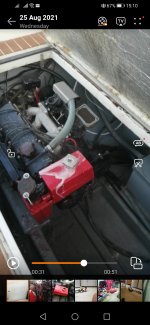

As you can see, the coolant being expelled from underneath the cap

Hate to say it but you have a blown head gasket. Going to 103*C (217*F) did some damage
Could also be the rebuild wasn't done right and caused the gasket to blow
