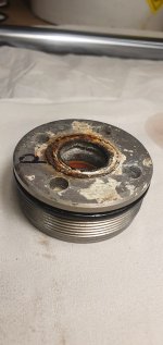

Don't worry too much about loosing fluid, it self bleeds in no time.

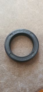

Replacing the seals is easy. However there is a supplier online who uses rotary seals instead of dust seals in the end caps, that might work but after only one season the garter springs have rusted.
The correct seal is AR 7979-PT. I got mine from a Yamaha agent!
Below is the spanner I made to remove the end caps.

Well, I got the job done. I'm not sure what you were saying. Rotary seals? Dust seals? I'm lost. I got the rebuild kit here: https://www.ebay.com/itm/334476790602
I got the job done and then may have screwed myself over at the very end by accidentally stripping the threads on the lower hose port. I'm trying to see if I can get them repaired/reshaped/whatever good enough to get the hose reattached so that all my work so far is not wasted.
