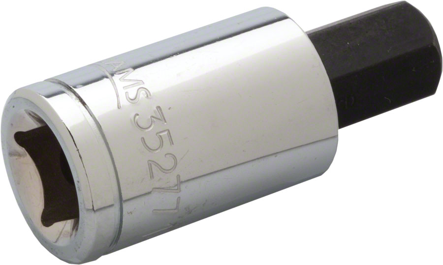

Didn't have the tool to remove those bolts.
1/2" hex wrench is all that is needed. Or I use one of these:
2598042104
The instructions that come with the Volvo OEM bellows also describes removing the bolts for the pivot housing.
