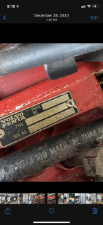

The 5.7GI (any more #s) could be anywhere from 1995 to 2021
Always add the year and the rest of the model#.

Thank you all. The boat is a 1997 with a 5.7Gi-f. The risers are cooled with sea water. The boat has been run its whole life in salt water. I did see a tiny bit of water leaking in the area you described. I tightened down the four bolts on the riser and it stoped the leak. I just been a little bit timid about cracking open the riser to check the condition but it’s on my list of things to do. I think in terms of just trying to figure out the temperature, I first was trying to understand what normal is and if the gauge or sending unit could be giving a false reading. I completely understand the process for replacing the exhaust manifolds and risers, Ive just been a little bit worried about breaking a bolt. I recently had the boat serviced getting all the outdrive maintenance taken care of, and the mechanic did mentioned that the exhaust risers gaskets needed to be replaced. The good news is that the previous owner provided a bunch of parts that were all very nicely labeled and in a box was a brand new Volvo Penta exhaust riser.
