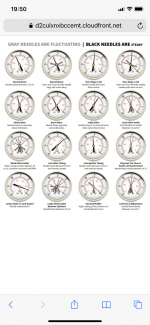

Yes power valve was replaced, it was a Volvo penta direct rebuild for Holley 2 barrel so I hope power valve is correct. I contacted Holley before purchasing to just buy a 2300 kit and they said the only that makes it Volvo Penta is the power valve and he didn’t know if a general kit would be the correct one so I spent twice as much for a Volvo Penta rebuild. Spark plugs are all tan. Even last years looked good minus the fogging oil which I cleaned off but still replaced.
I can’t find the documented vacuum readings on VP 5.0gl. Some articles say SBC should be 18-22 others say some engines are 17-21. One article said some engines like 15 to 17. It’s right at 17 and steady which is right on the border of late ignition timing. So that’s why I thought timing might be retarded but it’s actually advanced more then spec. Initial base timing is currently at 12 btdc, spec says 10 btdc for 89 AKI fuel. Yes, I am using the timing shunt correctly. Also should be 28 for total advance at 2400, mine is currently at 30 so it’s not retarded.
