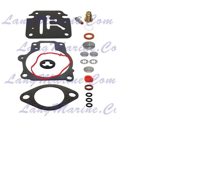

Hey guys thanks for the replies. I took it to a boat marina today and he had me back it down the ramp and spray a bit of carb cleaner in the carb as it was bogging. He said if the R's pick up its def a fuel issue. Sure enough, it picked up. So he had me pull my carb. We took it inside and he disassembled it for the 6th time (At least) and said "Its super clean inside here" So he started putting it back together. He grabbed the bowl and went to put it on and said "Wait a minute, isnt there supposed to be a rubber washer on here?" I said "Rubber washer?" So he went and grabbed a carb kit for my carb and sure enough i had lost a rubber washer that makes a seal against the idle circuit and bowl. So he put it in, reassembled my carb and she runs GREAT now!!. All this time and it was my fault because i lost a rubber washer by accident while taking the carb apart to inspect it. He charged me 29.99 for the kit and 10$ in labor even though we worked on it for a good 45 minutes. Old timers are the best mechanics! Thank god for him i would have never suspected it.

Sorry for the double post here is a picture of the washer i was missing

You the man boobie! Exactly what my mechanic told me to do also. I would have done that myself, but since id had the carb apart so many times, i was 100% sure it was correct! Ive never seen a rubber washer like this in any small engine carb ive rebuilt/cleaned and ive done 100's! Just not boats! Next time ill know.

Mine had that gasket rot away due to ethanol. I was having similar issues, I took the carb apart and it was super clean as well except for the crusty o-ring and the bits of rubber in the bowl. I ended up getting a viton oring (after a member here told me what size o-ring I could use as a sub for the one in the carb kit). My motor now runs great just as was the case with yours.
