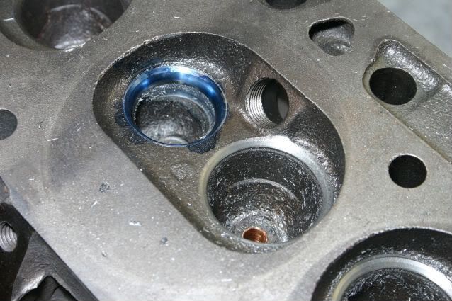

bigskiohio
Master Chief Petty Officer
May 3, 2008
882
Re: Valve Seat Question
Here is a exhaust with hardened seat installed, it a metal ring like stony says.
