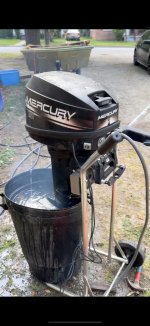

I am having trouble finding the year and model of this 15-hp Merc that I have. The sticker on the outside is too faded to read. Can I get some help? I took the foot off and have taken it apart to redo the seals because they are bad. I have never done this before and am worried about what brands to buy. If someone could send a link that would be awesome

That 0G number is your serial number. Punch it into the crowleymarine web site and it will give a year, model and parts list. If they have a seal kit it should be listed. If not, there are other parts places that you can look it up. Try ebasicpower, a sierra catalog or maybe iBoats.
