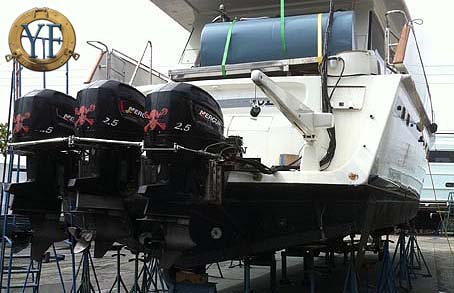

Philster
Sep 15, 2009
3,344
Re: Twin engine skippers - single engine ops possible?
47229d1310506408-mercury-outboard-powered-65-motoryacht-no-joke-merctrioyachtsplash.jpg
Leave the center one down and running. :D
