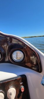

So in the last month or two, my trim gauge has been slowly moving higher. The full down position is now in the middle of the gauge.
Haven't had a chance to break out the meter yet, but is this typically a bad sender or bad gauge?
(And a pic, just because I'm looking at the gauge now!)

Its most likely the sender
Loosen the screws on starboard side, turn key ON and adjust. Might not fix it, but worth a shot
