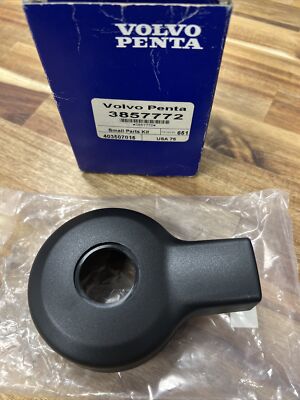

I don't like it, but this looks like it would work, as no matter what the issue is, I don't want that switch exposed to the elements anymore.
