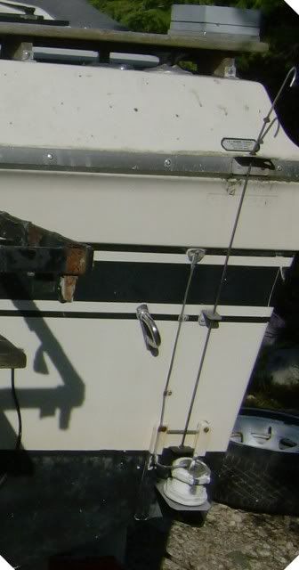

Re: Tricky Transducer Mount. Anybody creative enough?
Dangit! I just threw this bracket setup away. The garbage man beat you by a day or two. If i'd have seen this sooner i'd have just sent it to you. Anyway, maybe you'll like the concept. Its a bracket with a stiff wire that lets you raise the bracket a few inches within the uhmw (white plastic) guides on the transom when you run or are in shallow water. there is a bead on top of the wire that you slide over in the top bracket to keep it raised and then drop the bracket with the wire when you lower it. It's really simple. Maybe you can fab one up.
