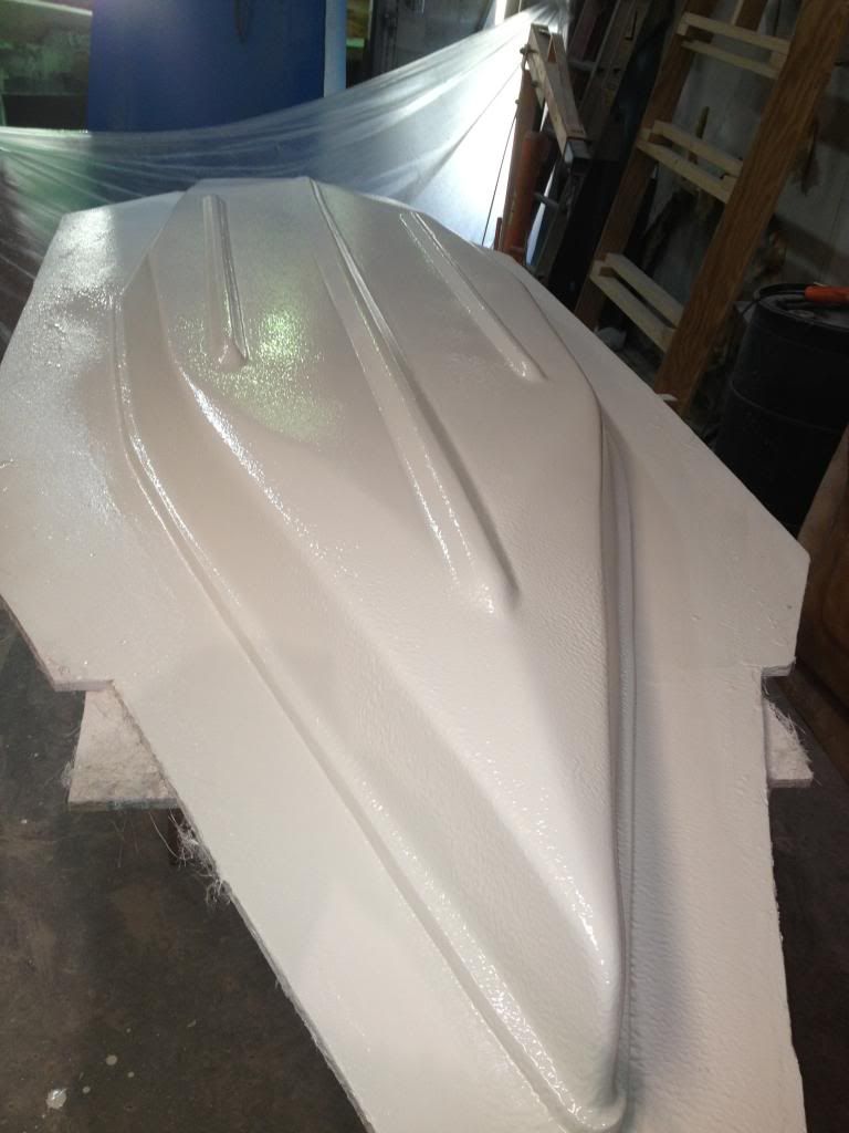

I build Layout boats out of fiberglass. Im now making more mobile boats But i cant seem to get the Kayak type layout to track straight once you stop paddling or pull behind you in wading water. How can i design the bottom to fix this? Im getting ready to make a new model and mold.

I suspect that given the design & draft (amount of the boat IN the water while occupied) of the boat you posted, it behaves more like a planing hull:
it can be difficult for a paddler to keep it moving in a straight line.
Even w/ the 3 skegs/keels/runners along the bottom...........
And w/ the hard chines, it catches an edge quite easily when pulled behind you as you wade thru marshes, making it seem like it doesn't track well when empty either.
However, sharp edges can catch easily, and although a perfect 90-degree chine would offer the highest performance, most boaters would find them impossible to control. Hard chines demand attention and good technique
Introducing a slightly more pronounced semi-V port to starboard below a larger center keel may help. Runners as you have them laid out are often of different sizes. Smaller (less pronounced) runners out near the chine & a central runner that is more pronounced (taller) acting as a keel.

I believe a lot of your problem is the difference between the curvature at the chine, side to side and the rocker of the hull. If you have an asymmetrical shaped object going through the water it will not track straight (it will turn away from the side with the greatest curvature) and the way your hull is shaped makes the profile very asymmetric as soon as the boat heels over a small amount.
