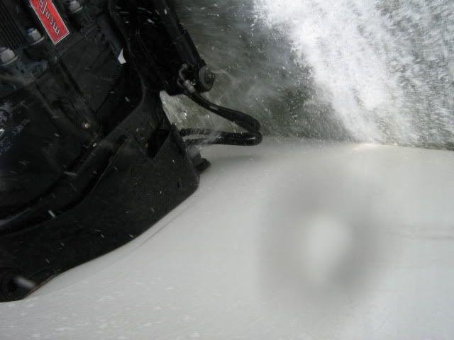

sounds normal to me too. they are relief holes. the water that can't exit the prop leaves through the idle relief holes. water could be pretty restricting when at rest...
that said. if your exhaust shutters fail and fall off (usually from an overheat condition), they can make it to bell housing and get hung up on the shift shaft and that could be and exhaust restriction. or they can blow all the way through too. it just depends on your luck if they fail.
a pic of mine while running.
i was surprised to see water exiting the relief holes at speed. but i don't think there's anything wrong with my rig. i just never looked before...
